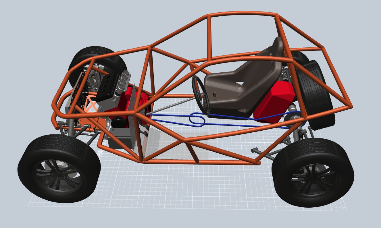

was thinkering with a chain drive solution
i see a couple problems with a chain driven midi like in this pic:
- short chain is usually overheating and short lived
- (with a LSD) there is no room for a "cush drive" dampener
- to get the correct gear ratio i would also need a similar huge rear sprocket :shock:
(and/or a smaller front one ... something that i definitely dont want to do)
on top of that no matter how i arrange things i just dont like the weight distribution, length and the seating position of a mid engine :ack:
so how about a front engine chain drive :idea:
rough sketch, but something like this maybe ?!?:
click here for high res pic: http://www.supermotors.net/getfile/1041990/original/spectre19.jpg
"packaging" of the engine in this orientation would be just fantastic (air box would be at the highest point of the hood/cowl)
radiator hoses, shifter, etc would be very simple ... i could even reuse the stock exhaust header :P
a stock GSXR 1000 has 17f/42r sprockets ...
with two chains i could (for example) spread the reduction over a 18f/46r front and a 36f/48r rear
(the 18 tooth engine sprocket would be easier on the chain)
stock (maybe Hayabusa sourced ?!?) cush-drive could go between the two chains at the idler block (in front/between the seats)
i think the strength of a high quality o-ring 530 HD series chain should not be an issue ?!?
what do you guys think about that :?:
- Stephan - Image

A Giubo joint would take care of your cush drive requirement, that could connect 2 short shafts easily.
One of the members, whose name escapes me at the moment, did something similiar and raced it quite competitively on an ice course.
I'll see if I can remember enough to run thru the search engine.

Here it is, http://www.locostusa.com/forums/viewtopic.php?f=36&t=13049&hilit=snow+course.
OK, my memory was a little off, he built a 4x4 with the engine in the middle driving a forward and a rearward chain.

Jack
thanks for the link :cheers:
yeah, if this project would be a strict track (or dune) weapon i would definitely go the Palatov dp4 inspired direction ...
... of a true midship engine AWD single seater 8)
but for a "toy" i prefer RWD (not ideal traction wise , but high in the fun factor :mrgreen: )
or if money would be no big factor,
i would join a inverted (high pinion, but standard rotation) Quick change with a cush-drive joint direct to the (turned lengthwise) engine
talking about QC;
i actually like the fact that with two sets of chains i have the ability to fine tune the final ratio in a similar fashion (but not as fast as with a QC)
530 series sprocket selection is huge ... and the chains are available in XL length (for drag bikes with extended swing arm)
i think i also have a solution for the cush-drive already;
it seems that Suzuki flipped the Hayabusa cush-drive around sometimes between model years
there are male and female sprocket hubs available
the 99-07 hub had the "bell & paddle" part in the sprocket hub;
but the 08-14 has them at the rim;
so in theory i should be able to join the two parts (with the rubber C-cushions in place) and i would have sprockets on each side :o
the parts are fairly cheap so i may order some used ones off e-bay and try it out
- Stephan - Image
