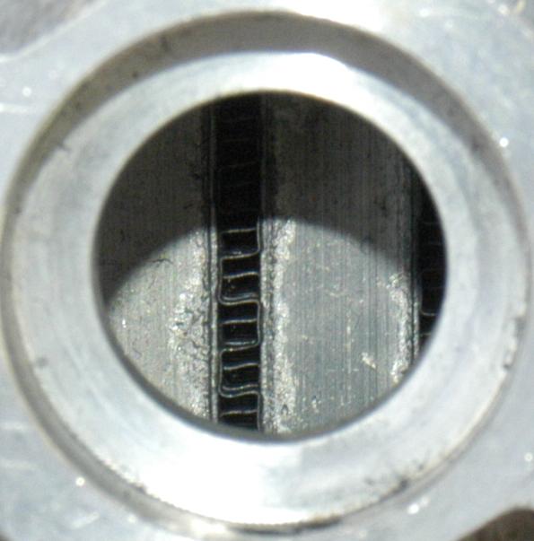

Do you guys think this oil cooler will be enough to cool a street ported 13B for autocross? I have it sitting in my house right now and would like to put it to use. The core is only 8x11" but rather than using tubes and fins it has 36 rows of stamped aluminum so that oil is flowing through all of the metal on one side and all of the metal is exposed to air on the other side to provide maximum heat dissipation. The other nice thing about this cooler is that unlike the OEM cooler, which is very long, I can attach a 9" 1550CFM pull fan.

How hard would it be to setup a test with a hot plate some 10-W30 and two thermometers?
I think a real world test, installed would be best, but I'd accept the above test with a fan over "assumed math" any day.
Don't worry too much about oil temp at an autocross; it's not going to get very hot running 60 seconds at a time. Water maybe, but not oil. OTOH if the car will ever see trackday events than it's a really big deal.

I would like to do some HDPE events, but no competition. I guess I'll just keep a careful eye on the temperature gauges and upgrade if needed. I'm using a civic radiator but it's the 2 3/8" thick Bar & Plate design, which has WAY higher flow than a traditional tube and fin radiator, and a 14" pull fan.

After talking with other rotary seven competition car owners, where you put the cooler or radiator along with shroud design and hot air exit form the engine area is just as important as the cooler/rad size.
If you are considering a mostly track car you might want to check out an electric water pump to keep circulation after the engine is shut down.
I think you are on the right track adding auxilliary fans for the oil cooler. I am doing the same.
If you can, mount the oil cooler away from the radiator. It will help both keep cool. Make a shroud for you oil cooler too!
I also heard that the oil to air cooler found on a early 80's 12A is a very good unit (likely better than most "race" units) IF you can find one. It is a rather large unit so it might be an issue on where to mount it.
