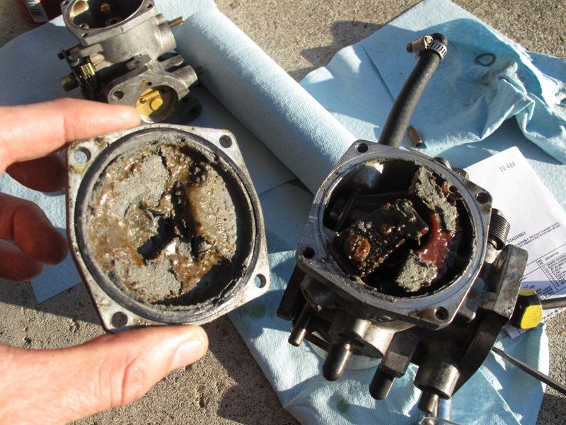

Them's some seriously fugly carbs!!! I'm surprised it ran at all... Good move to clean 'em up and rebuild. :mrgreen:
I did a carb overhaul on an MG for a "friend of a friend" one time, and there was so much dirt in the float chambers that I told the owner his car was now named "Aggie". When he asked why, I told him it was in honor of all the "agriculture" I had cleaned out of the carbs!!!
I wish ya continued good luck, and keep us posted!

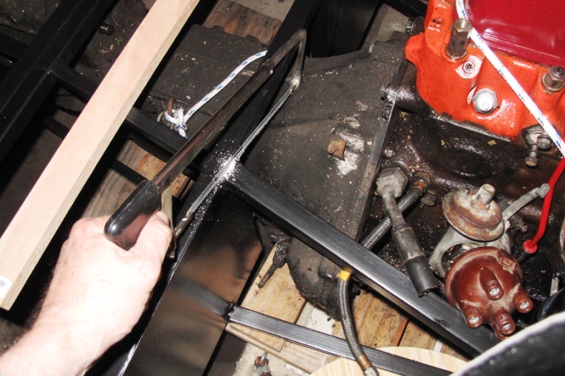

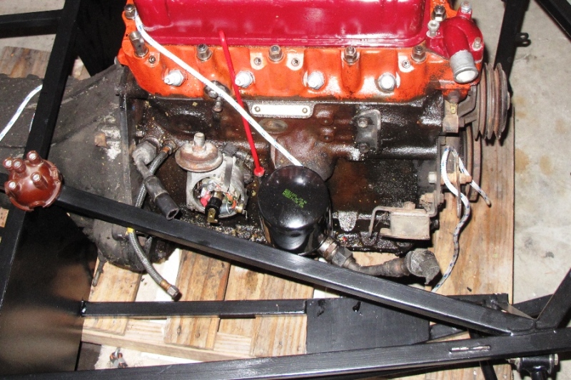

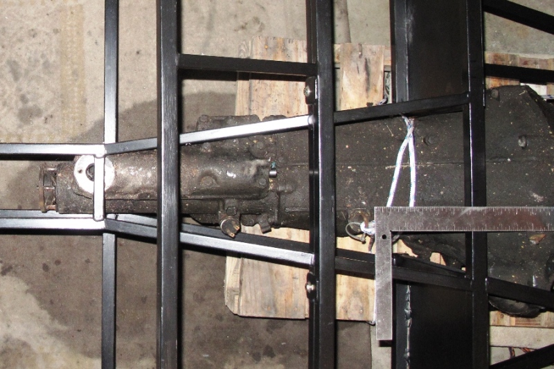

I dropped the M.G. engine and trans into the mock-up frame to see how everything would fit. Almost nothing did. The frame was built using all book measurements, and it's obvious now that the steel frame won't be. First problem was the transmission tunnel, which was okay on the passenger side but not on the driver's side, because the turret is offset from the centerline of the output shaft. Next problem was the R-tube, which was at the exact same height as the oil filter and distributor and wanted to run right through them. And then the center H-tubes were too close together, but I knew that already. What I didn't realize is that the passenger's side needs to move farther outboard than the driver's side in order to clear the slave cylinder.
Fortunately the mock-up frame is made of wood and is easily modifed. I knocked out a transmission tunnel tube to clear the offset turret, and moved the R-tube three inches back to clear the filter and distributor. Unfortunately I couldn't easily chop out the center H-tubes, but I was able to get the distance between the engine backplate and the lower firewall down to 4-1/2" with the current H-tube spacing, and could easily get it below 4" with another inch of clearance on either side. At 4-1/2", the transmission turret doesn't quite reach past the front transmission tunnel crosstube. At 3-1/2" it should clear with half an inch to spare.
It's great having the mock-up frame, although it's starting to take quite a beating from all the test fitting.

BTW, for future builders reading this..... This is what happens when you don't have your drivetrain ready for fitting before you build the frame. Sorry Nick :cheers:

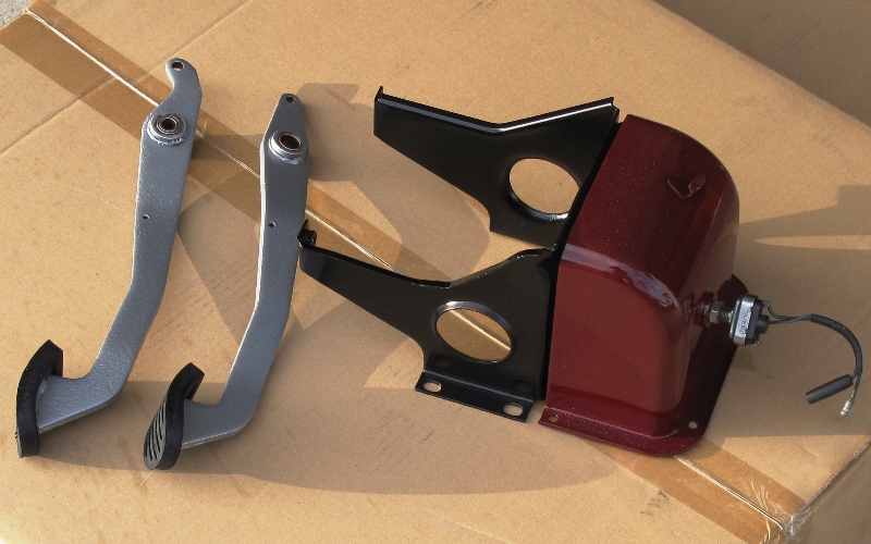

Dismantling of the donor is taking a lot longer than I expected, mostly I think because I've been spending a lot of time cleaning and refurbishing the pieces that come off the car. Apparently I don't like having a lot of crusty parts sitting around the garage.
I cleaned up the engine and transmission quite a bit, but it still needs paint. I think I'll just paint the head black and call it done. The dipstick also needs to be repainted the correct shade of M.G. red. I made some more changes to my mock-up frame and got the engine and transmission to fit with room to spare. I also trial-fit a lot of other donor parts on the mock-up frame, and I'm starting to get a pretty good idea now of where everything is going to go. Very encouraging.

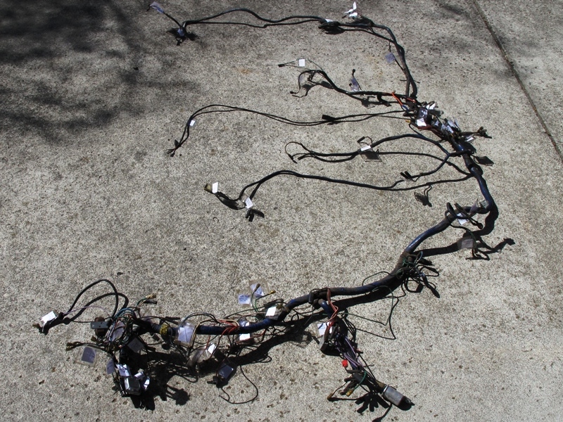

The biggest job in the whole dismantling process has got to be the wiring harness. Luckily, this is one of the great things about my donor. Except for the mess under the dash, it's a really simple harness. This is everything except a small harness (8 wires) that runs to the back of the car, for the lights. I labeled everything, but it's so simple I almost didn't need to. Except for that mess under the dash.

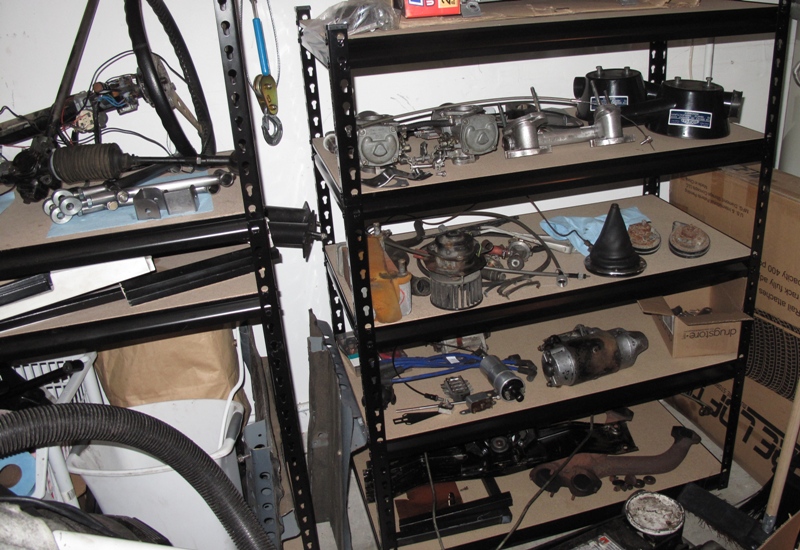

I got some new shelves for all my new Locost parts. As stuff gets cleaned up, it goes on the shelf. I'm hoping this makes the build process a lot faster, and a little bit cleaner. But probably not.
I think you are doing it the right way. I can't stand working with crusty, greasy parts. Especially if I have to handle it more than once. Which is always the case since you generally have to take thing off the donor then later, put it back on the locost (at least once if not a dozen times.
