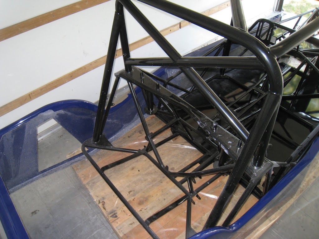

I got my kit home yesterday! After travelling across the Atlantic on the OOCL California my container was offloaded in New York. From there, my crate was scanned in customs and then made its way to OST Shipping in Baltimore. I rented a uhaul and picked it up yesterday. I used IAN International to get through customs and I have to give a nod to my agent there, Jessica. Everything was very smooth.
My crate was in good condition when I got it and everything looked packed well. As far as I can tell nothing was damaged in shipping which is a big relief. Now, on to the pictures!

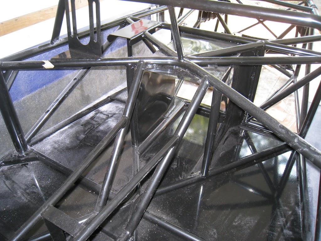

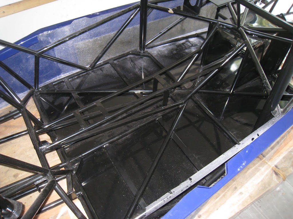

I am really impressed with the frame. It appears well thought-out, good mitering and welds, and the powdercoat is a great finish. Also, MNR did a custom engine bay for me because my bike engine sits on the right rather than the left.

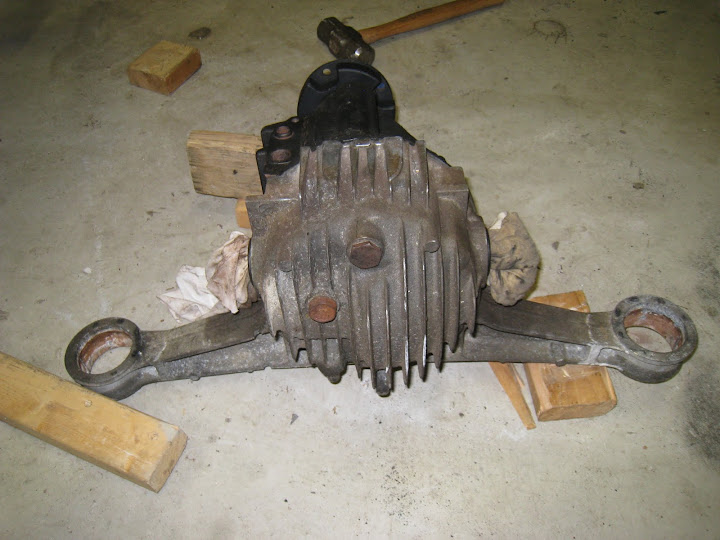

In other news, the first parts have been bolted to the car! The powdercoat had made the bolt holes too small and so I had to drill them out. I also removed some metal so I ended up applying Por15 to make sure the fresh metal was protected.
Also, spent some time on the differential. I got the old bushings out, and the aluminum housing cleaned up and primed for paint. I think I'll do dark blue (to match the body) on the aluminum portion and keep the cast iron portion black.
