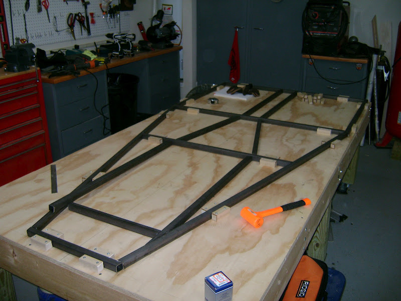

Anyways, on to real car stuffs (and table stuff). My table is just 2x6 framing boards, with a 3/4 veneer-core cabinet ply top. I leveled the frame, then placed the top on it. I "soft" screwed it down, so it couldn't shift, then used a 48" straight edge to shim the middle and perimeter until I had it flat (I think it took somewhere around 15 taper shims). It's a similar way to one you would use to level and flatten an old pool table (which I actually did last year to my own pool table). No, once you get some weight on it it won't stay flat, but I really only need it to stay flat until the front portion of the chassis is welded. After that point, the frame will warp on it's own (limited as much as possible) and then it's a done deal.
It actually has 6 legs, not 4 like is shown, I added 2 more the next day before shimming
Anyways, NOW car stuff. The chassis, like I mentioned earlier, is a modified Haynes. The most major change, I expanded the cockpit area to 46" across. I wanted to go with nicer seats than a kirkey or home-built, so I decided I needed at least 19" across the seating area, and to do that I needed a wider frame. The front width remained the same, however, so I have a higher degree of taper from the cockpit to the nose. This allowed me to just use one piece from the cockpit to the nose, instead of the bend in the middle around the firewall area. I also raised the rear bulkhead height to 24", and am using 1x2x.120 for the bulkhead sides, and stitch welded 1x2 for the bulkhead top, with threaded inserts welded in for the roll bars and shoulder belts. The rear design is still waiting for the finished live axle design, can't fill in that blank yet.
Initial layout

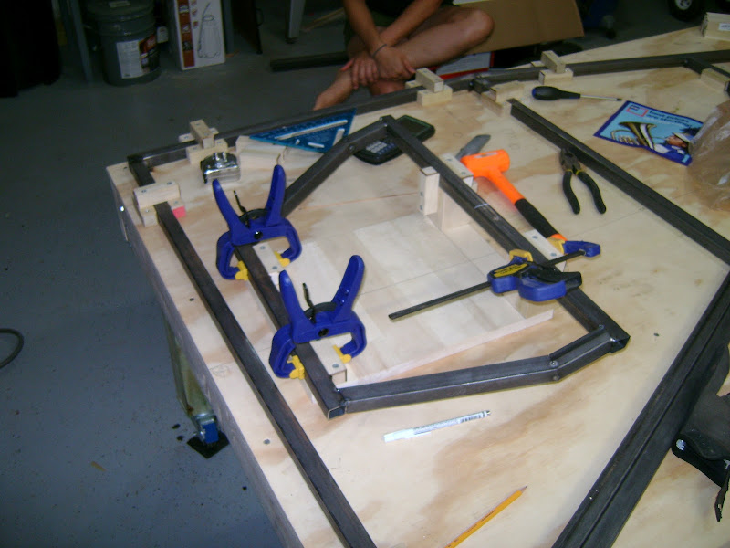

Clamping
Front Sus. Box
