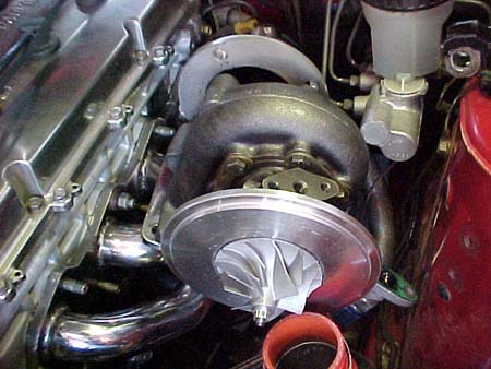

Ok.. so I've found a nice Garrett T3 turbocharger for free, and have already picked up an intercooler out of a Nissan Skyline with blowoff valve and misc piping that I can modify. I have also been offered a turbo manifold for this engine for a very reasonable price.
My question to you guys is ... Am I crazy?
I work out of a shop that specializes in 240's. We dont bother building KA motors but rather swap them out for the sr20det's. The sr's are a much better motor to build up then the KA for several reasons but I wont go into that.
I think you may be taking advice from the wrong people as to what you should do with that motor. Most of the people who build up KA motors for thier 240's are kids that dont have the money for an sr swap. The KA motor was never designed for performance and was only offered in the states as a replacement engine for the sr because of smog.
The picture of the turbo manifold is china made and cracks/breaks very often. The fit is poor and they usually leak and come loose because the flanges are not machined.
Yes, you will get more hp if you put a turbo, but any motor with a turbo will make more power.
Do I think your crazy? Yes, I do think your crazy for listening to internet kids that dont really know what they are talking about or are just trying to sell you some crappy parts. Most of the time, when people buy stuff, they sware by it because they need to feel that thier purchase was justified and they made the right choice.
Dont take advice from the people that have only owned or tried just one setup, or the guys selling you the parts because thier opinions will always be biased towards what they sell or what they have.

Thanks for the words & advice.. I am not going this route strictly because someone has told me that it is the best way to do it. I am going this way because it is the cheapest way at this time. An SR20det would be great, but it is well outside of my budget. This engine is a good one and will be fine to get the car going and play around with. The turbo parts I have acquired for next to nothing, so why not? I'm not about to go drop the coin on an SR20det because you say the KA isnt worth building.. that'd be silly.
The manifold I posted the photos of is NOT the manifold I've been offered. It was the closest I could find. After taking measurements, I'd have to build my own manifold anyway, as theres just not enough room for a top or bottom side manifold, so the point is moot.
Thanks for the 2c...
