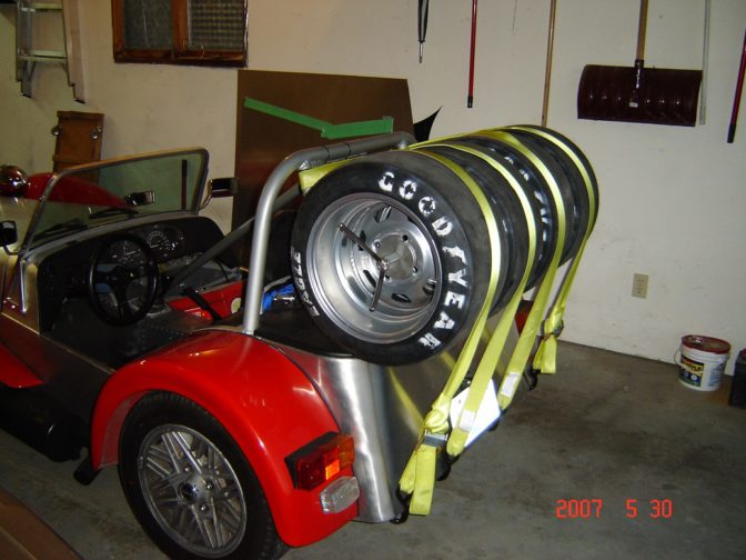

If you have a hitch on the 7, I'd say one of those hitch 'baskets' of sufficient size to hold 4 tires would do it.
I've also seen some custom builds specifically for carrying wheels, in effect 2 bars on the bottom with a bar going through the center of the wheels, towers on each end to hold the center bar in place.

I never liked the "hitch baskets" that use a single receiver due to the rocking L/R. I built my own using 2 receivers. It would be easy to modify the concept to carry 4 tires and a toolbox. Building one to suit your specific needs should be easy for a Locost builder.
viewtopic.php?f=35&t=4145&start=318

The double receiver is a great idea for stability & could up the weight capability as well.
Your design could easily be modified to accommodate a tire carrier model.
