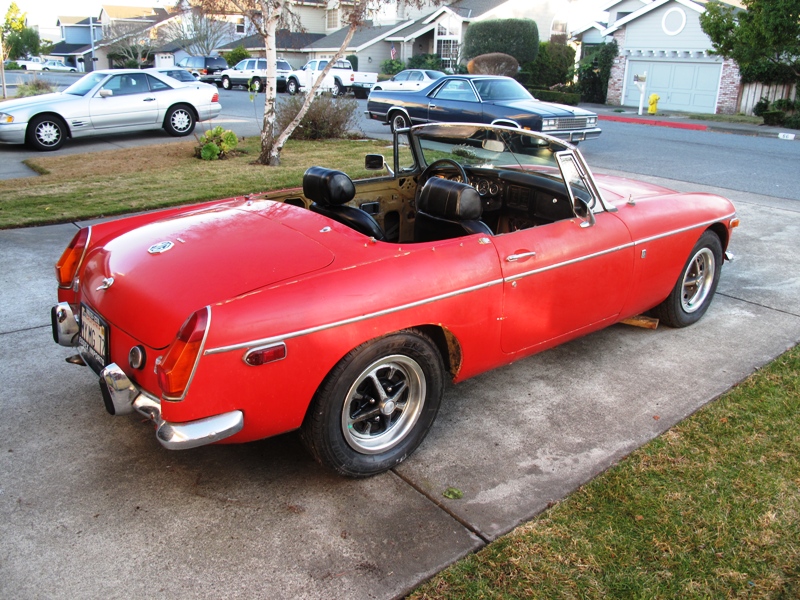

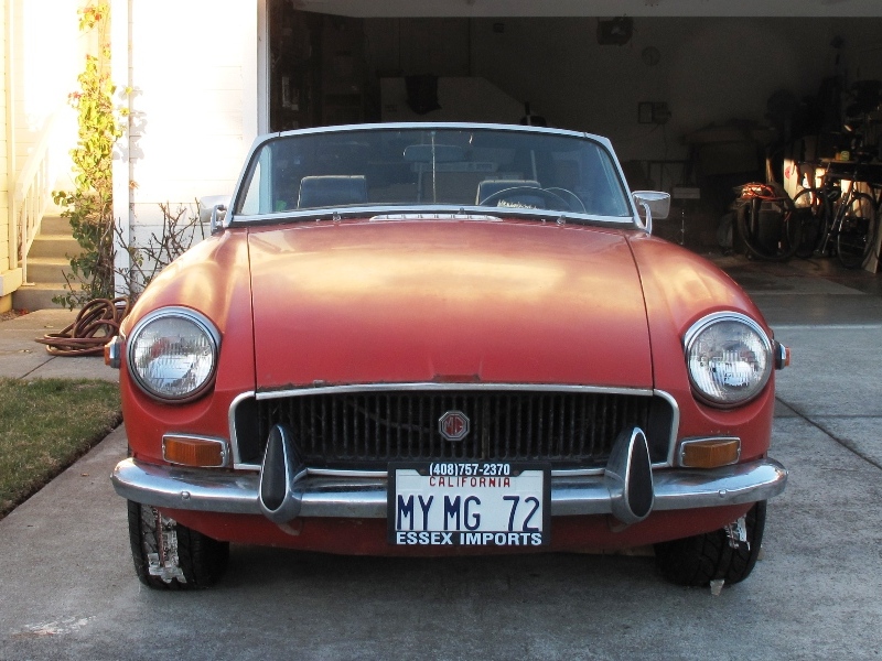

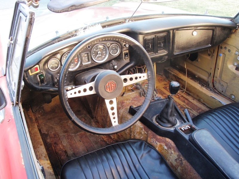

I've finally got a donor! It's not in too bad a shape for a 40-year-old car, the usual rusted body panels but the drivetrain looks good. The tires that came with it are brand new, which might seem like a great deal except they were manufactured in 2001. Wouldn't be the tires I'd want on the Locost anyway. Best thing about having a donor? No more guesswork. I need to know how big a part is, it's right there.
The car has been sitting for a couple of years and hasn't been started in all that time. I'm wondering if I should try and get it running now, or wait another year until it's in the Locost and get it running then. I'll probably wait. Frame tubes are all cut and ready to go. Once the donor's apart, I'll start welding.
 Post subject: Re: Nick's MGB Build
PostPosted: January 16, 2012, 11:26 pm
Toyotaphobe
Joined: April 5, 2008, 2:25 am
Posts: 4829
Location: Fort Worth, Texas
Start it and drive it a while to be sure (what)things are working.
And which aren't.
This way you have an idea of what you've actually got.
mobilito ergo sum
PostPosted: January 17, 2012, 4:49 pm
Joined: July 4, 2006, 5:40 pm
Posts: 1994
Location: Novato, CA
Yeah, I'm starting to think you're right. But if I'm going to do that, I'm going to pull the head and oil everything before I try to fire it up.

Thanks all. MGBs and I have a long history together, although that was some years back. I think I can still R&R a head in under 2 hours though, and I'd like to get a look inside the engine, as well as replace the gaskets. The radiator is full of clean 50/50, and the crankcase is full of oil that you can still see through, so it all looks promising.
One of the things that sold me on the car was unscrewing one of the SU dashpots and hearing that familiar oil-sucking sound as I pulled up on it. I think the carbs are okay. In the trunk I found one of those carb balancing tools, the kind with the floating ball, which although never worked well for me at least shows the last guy who had the car running probably took good care of it.
The brakes are spongy but appear to work. I had the rear drums off to adjust them and they were all clean and dry inside, and the linings looked like new. The clutch reservoir was empty and the clutch pedal goes to the floor. I refilled the reservoir but it's not going to work without bleeding. And Castrol LMA is all I ever use in all my cars except the track Miata, so no issues there.
I appreciate all the input. I'll let you know when I get it started. I might even take it for a short drive.
