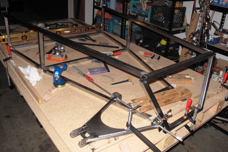

I assembled my build table today and started tacking the frame together. This did not go nearly as quickly as I expected. I assembled the table in only half an hour but spent the next 6 hours getting it flat. Another hour to draw lines on the table, and another 4 to lay out the bottom tubes and clamp them in place. Finally I got out the MIG welder, and when I tacked the first corner I got this ugly, porous bead. Some kind of contamination, I figured, so I wire brushed the next corner really good and tacked it. Same ugly, porous bead. That's when it hit me I hadn't turned on the gas yet. Not a great start.
I ground down the bad tacks and started over with the gas on, and this time everything went okay, although it seemed like each tack took at least 15 minutes to set up. I ran out of time after tacking the top of the tubes, and just had time to flip the frame over and check it for straightness. Amazingly, it came out okay, but I'll feel better when the bottom joints are tacked, maybe tomorrow if I get the time.

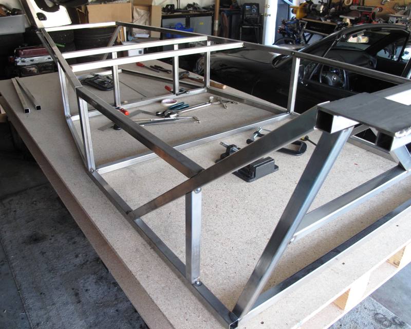

It's actually beginning to look like I'm building a car in my garage. The frame is going together amazingly straight, if not amazingly fast. Ordinarily when something goes this well I'm doing it wrong, but I haven't found anything yet. There's still time, though.
I guess I ought to clear off the table before I take pictures. I'm not a terribly neat worker but at least I usually know where something is when I need it.
This is all really encouraging. I'm almost starting to think I can actually do this. I have just about all the parts I need, and there don't seem to be any major obstacles anymore, except maybe the bodywork which seems kind of intimidating.
With all of these steel tubes starting to resemble a car frame, I had to try clamping on a couple of suspension bushings and attaching one of the lower A-arms. It looks so good I may just leave it on there for awhile.

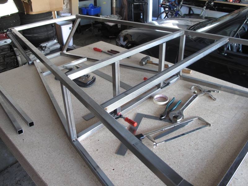

The frame has gone together pretty fast. That may have something to do with the fact that I've spent just about every waking hour on it, apart from my actual day job. I still have to figure out how I'm going to bend that 3/4" DOM tubing, but if I can do that, I think I can finish this thing tomorrow, or Sunday at the latest. Well, not actually finish, but you know, start welding things on.
The tunnel is shaped to fit a late-model MGB gearbox, which is big enough for a truck. The mock-up frame was invaluable for getting the dimensions right. The turret on the transmission is offset to the left, so I had to start widening the tunnel early. Tubing is 1" x 1/2" instead of the usual 3/4" square, same weight and strength but a little more room in the seating area.
