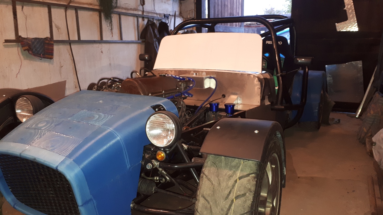

By the way about the windshield. I made a couple of brackets and bought a monolithic polycarbonate with a thickness of 5mm.
And now I think how to make a frame. I also like these visor, but given the ruble exchange rate, the final delivery price is expensive. http://www.kitcardirect.co.uk/mk-indy/m ... n-grp.html Maybe there are cheaper options?

Yes Niko cylinder head is also tuned. I increased the diameter of the intake and exhaust channels. Established bronze guides. As well as lightweight valves, spring plates made of new aluminum, lightweight rocker arms of valves. As well as wide-camshaft. 310 degrees at the inlet and 300 degrees at the release, overlapping valves 2.4mm.
For tyunig coilovers ordered a new main piston with enlarged bore holes on the rebound, as well as a new return piston and PTFE sealing rings. Made everything on a CNC machine.
