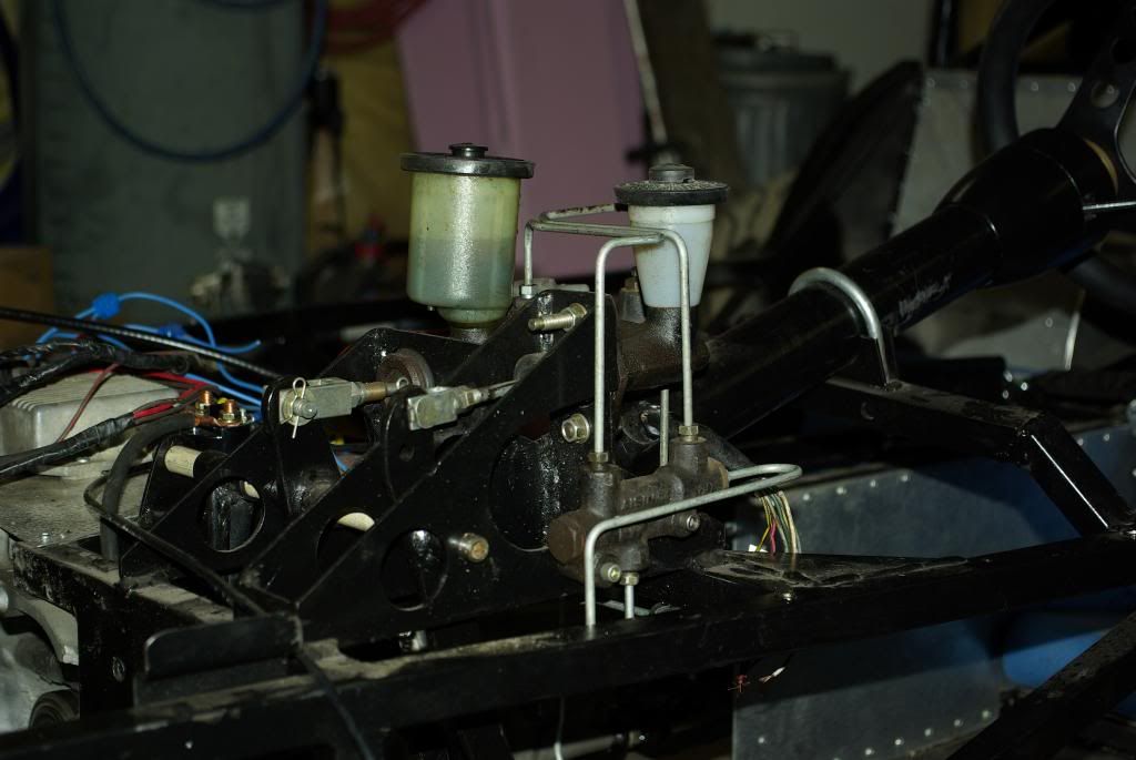

Homemade pedal box

The diff, front spindles, and brakes are from a Corolla, as well as the e-brake, master cylinders, and proportioning valve.
