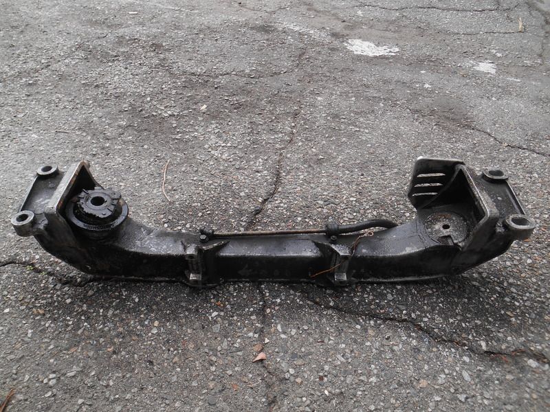

I started with the front subframe, it was pretty nasty
and heres an after picture of using some purple power and some elbow grease. A parts washer wouldve been easier and had a better result, but I dont have one so...

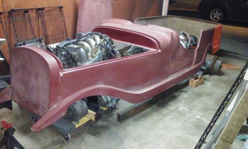

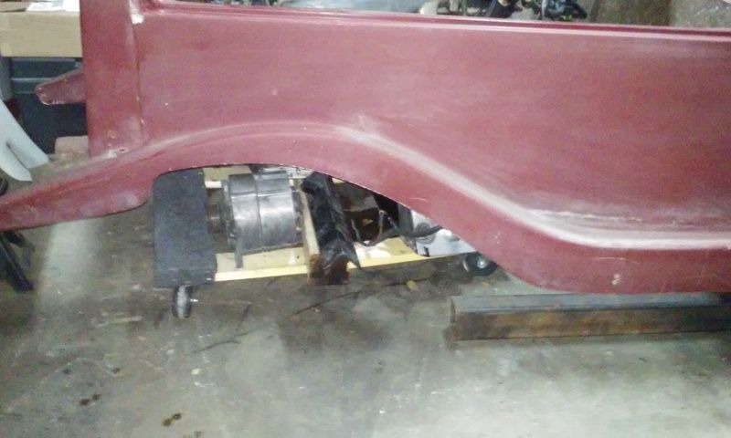

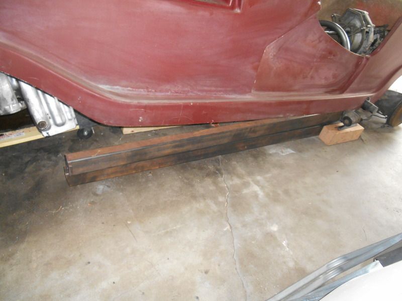

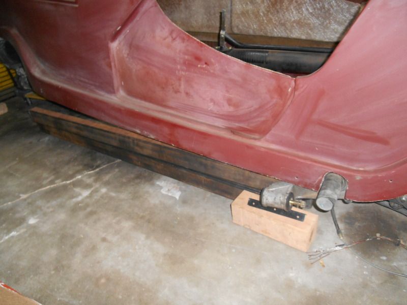

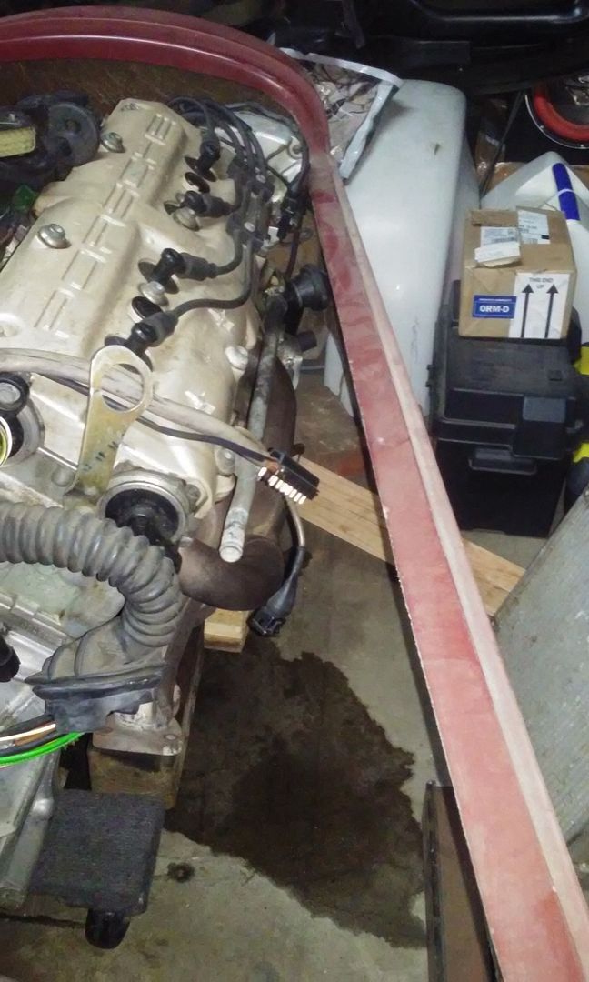

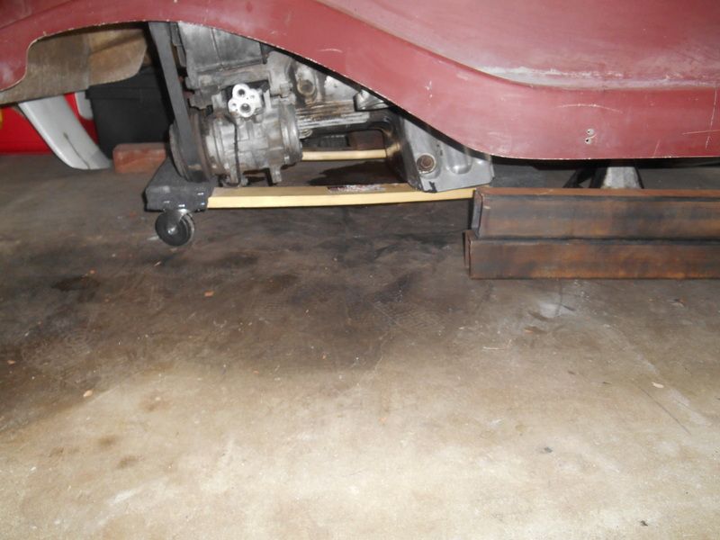

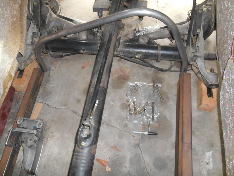

Had a chance to mock up and get a rough idea of how the frame rails will line up with everything and so far it looks good. Of course, once I start welding stuff, it could get worse or not. Fingers crossed that it still looks good
down low from the side
another view from the other side

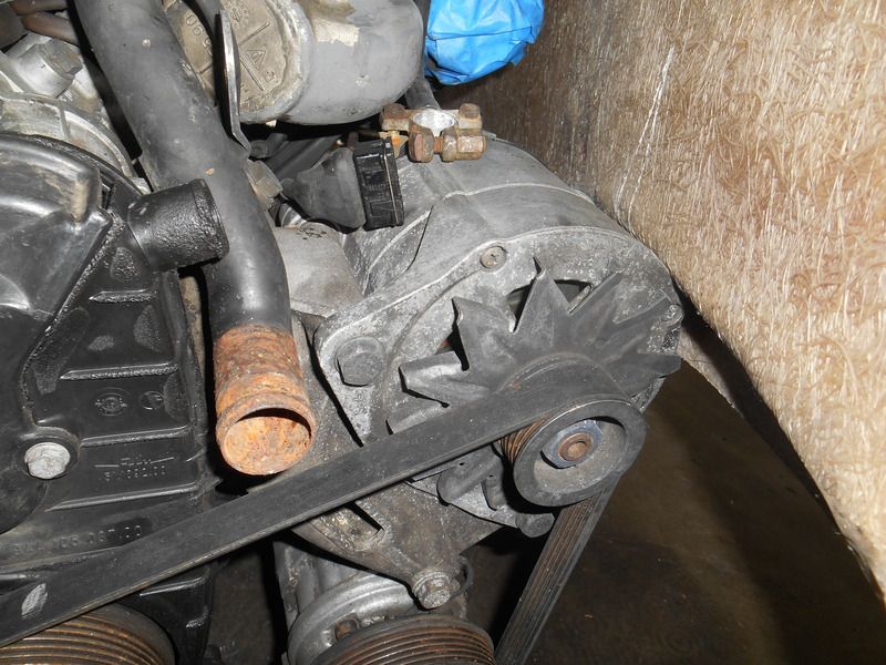

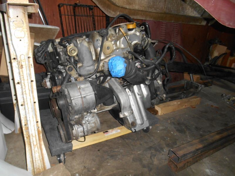

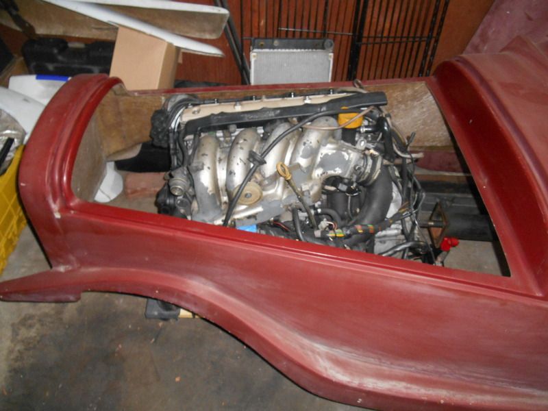

The bad news is that the alternator doesnt quite fit... who needs an alternator anyways! I will just remove it... No, seriously theres either a power steering pump or A/C pump on the lower end and I will try to mount the alternator down low. Granted, this may not be an issue once the torque tube is totally bolted in place.
Its pretty tight right now
And on this side, the cap also interferes, but I cant really move this. Im hoping the motor will move back a little to gain some clearance, but for now its something I have to be aware of
and some loose & tight gaps that will help things along when they get shut.

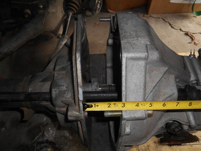

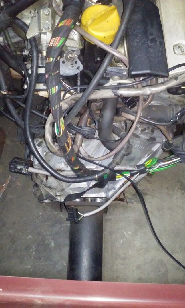

Heres the gap between the torque tube & the bellhousing
Is there supposed to be a gasket here or something??
Im missing the nut & bolt that holds these splined sections together but this will tighten things up a little

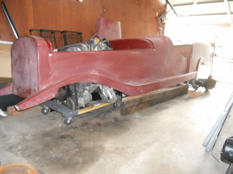

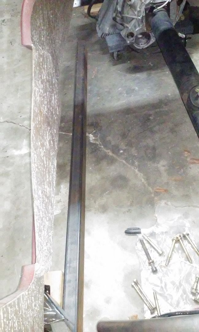

I got pretty lucky blindly buying this rollbar from a member here and it fits like a glove!!!
Its just mocked up next to the roughly where the frame rails should sit and the width is but its pretty damn good! Obviously there will be another layer of tubing, but this makes me pretty happy about how this whole project will turn out
Still fits behind the rear panel !
and up front, I hope we move closer to the firewall that I havent made yet

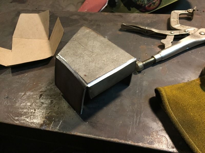

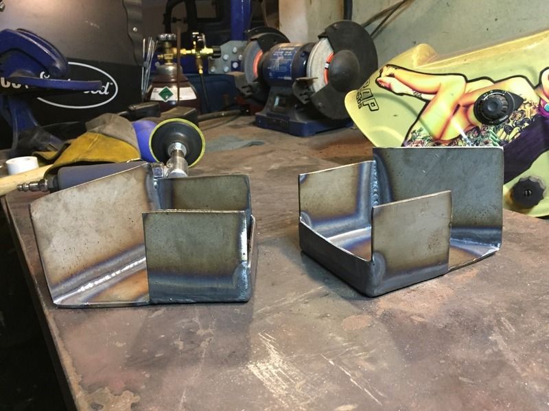

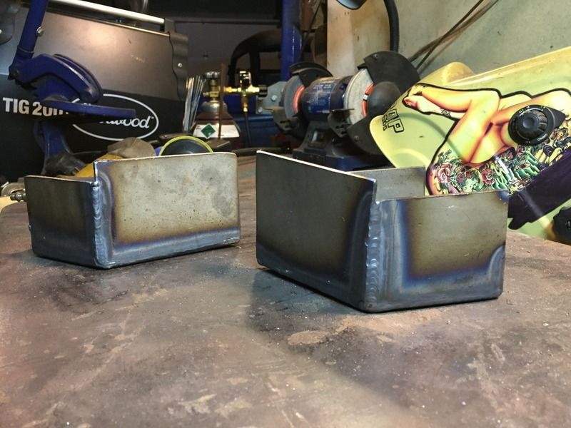

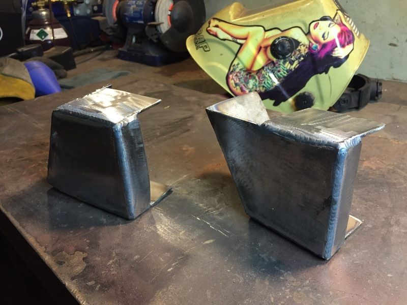

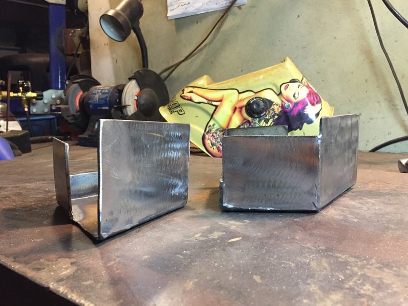

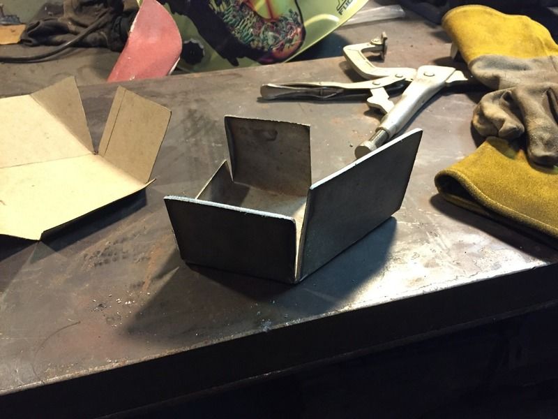

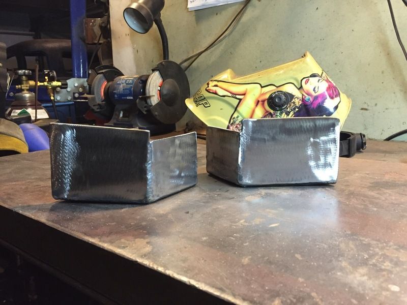

Matt did it at the last minute, but he sent these last night. Im so excited to see my "CAD" transferred into metal 3000 miles away.
Welded up!
All done and cleaned up!

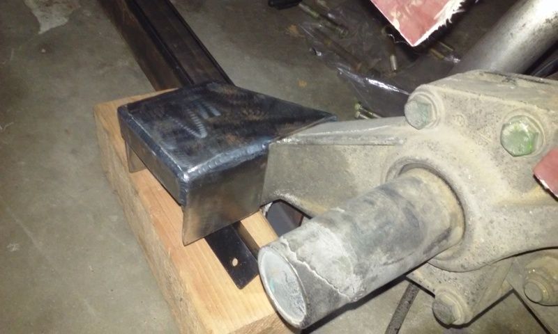

First thing I wanted to do was to see if my subframe MOUNT would fit correctly, and Im very happy to report that it fit like a glove! This totally made my night
I will have to be careful as to how I cut the 3"x2" frame rail since it will now get an angle cut to weld on to the mount. I think this will be stronger than a straight flat edge weld because there will more surface area being welded to each other. I will also be adding a gusset to make sure this is not a weak point.
You can see here how the angle the MOUNT takes in relation to the frame rail
and here you can see how far up the other side of the frame rail goes
Moving on, I had another goal of removing the alternator, the a/c compressor and the MOUNT :lol: This was because I wanted to see if this would be enough to allow the body to slide down over it all, and again.... PERFECT! Im going to go get the MOUNT from a wrecker in northern california this weekend since Im going up to pick up wheels for the Gazelle, and some other parts for my E30. Im fighting the temptation to sell the E30 because it will be one less project car and a lot more money will be free for this project.
Some more pics of the fitment of the body over the motor. It also helped that the torque tube pushed in further into the bellhousing. Its still tight on the backside but that gap is still there. This project so far is coming along great. I get more and more excited each step of the way
Good clearance on this side
Still a little tight on this side because of the distributor cap, but it clears
basically ready to be bolted up here
