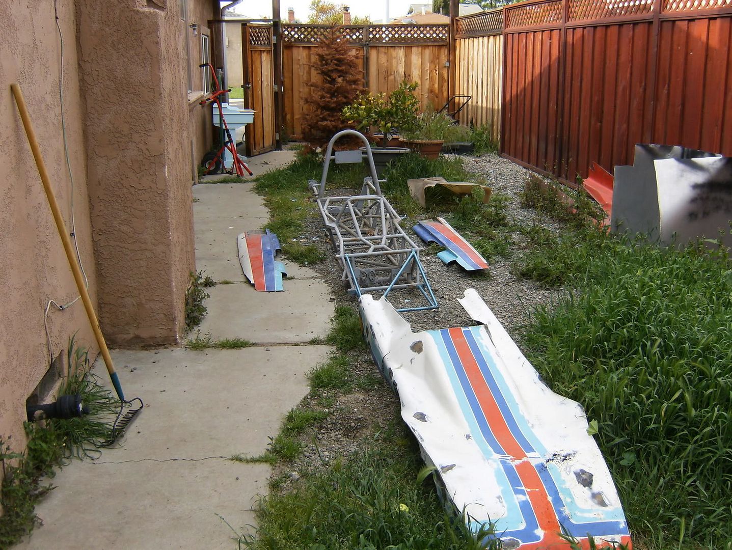

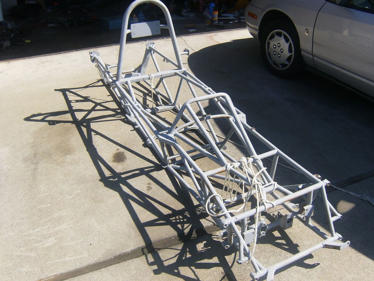

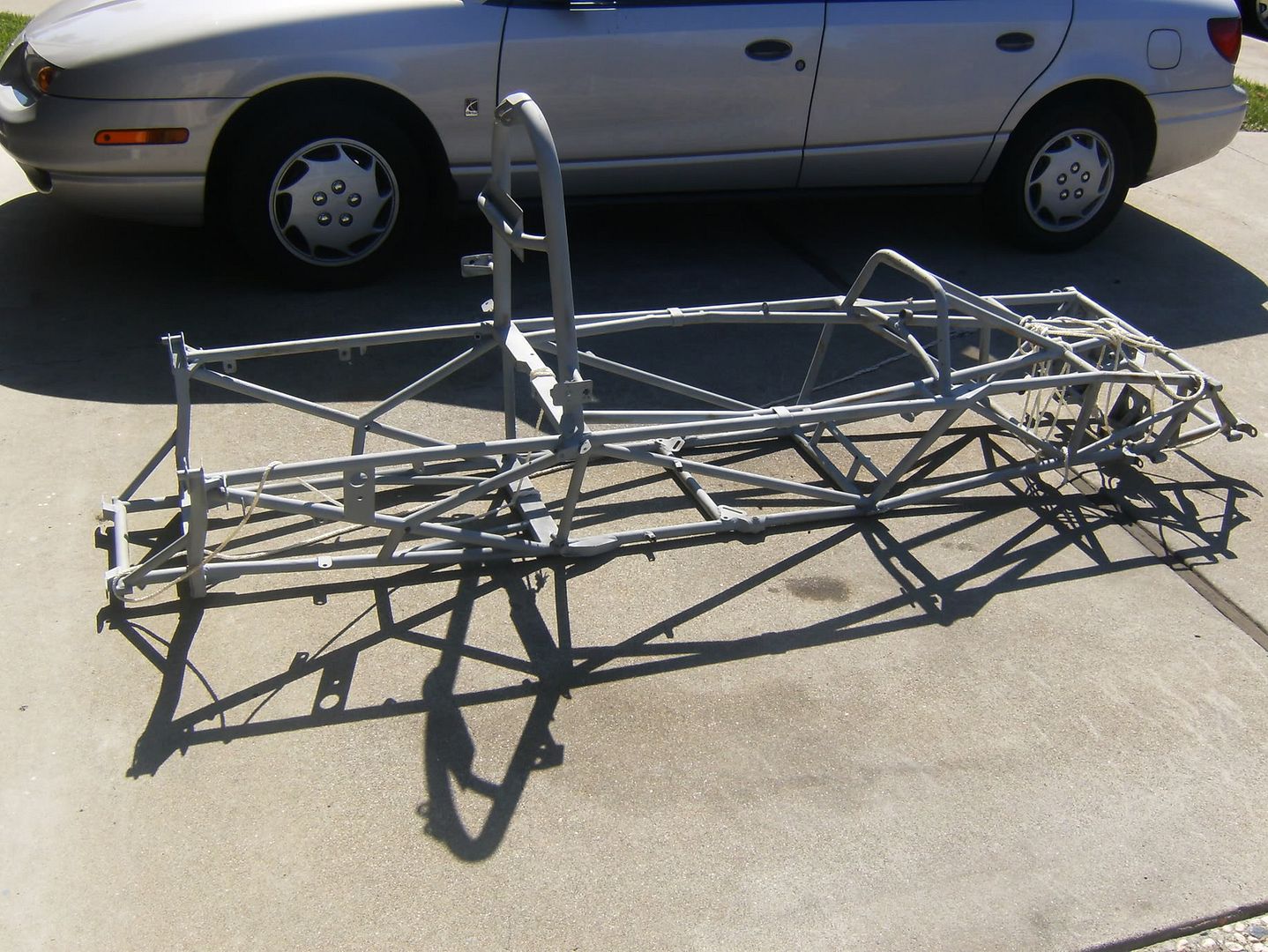

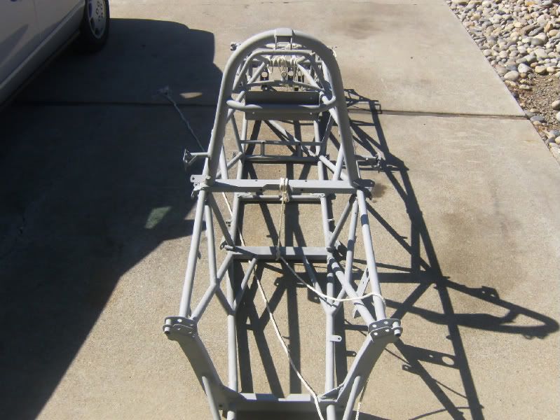

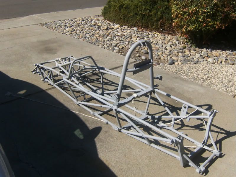

Pics as promised:

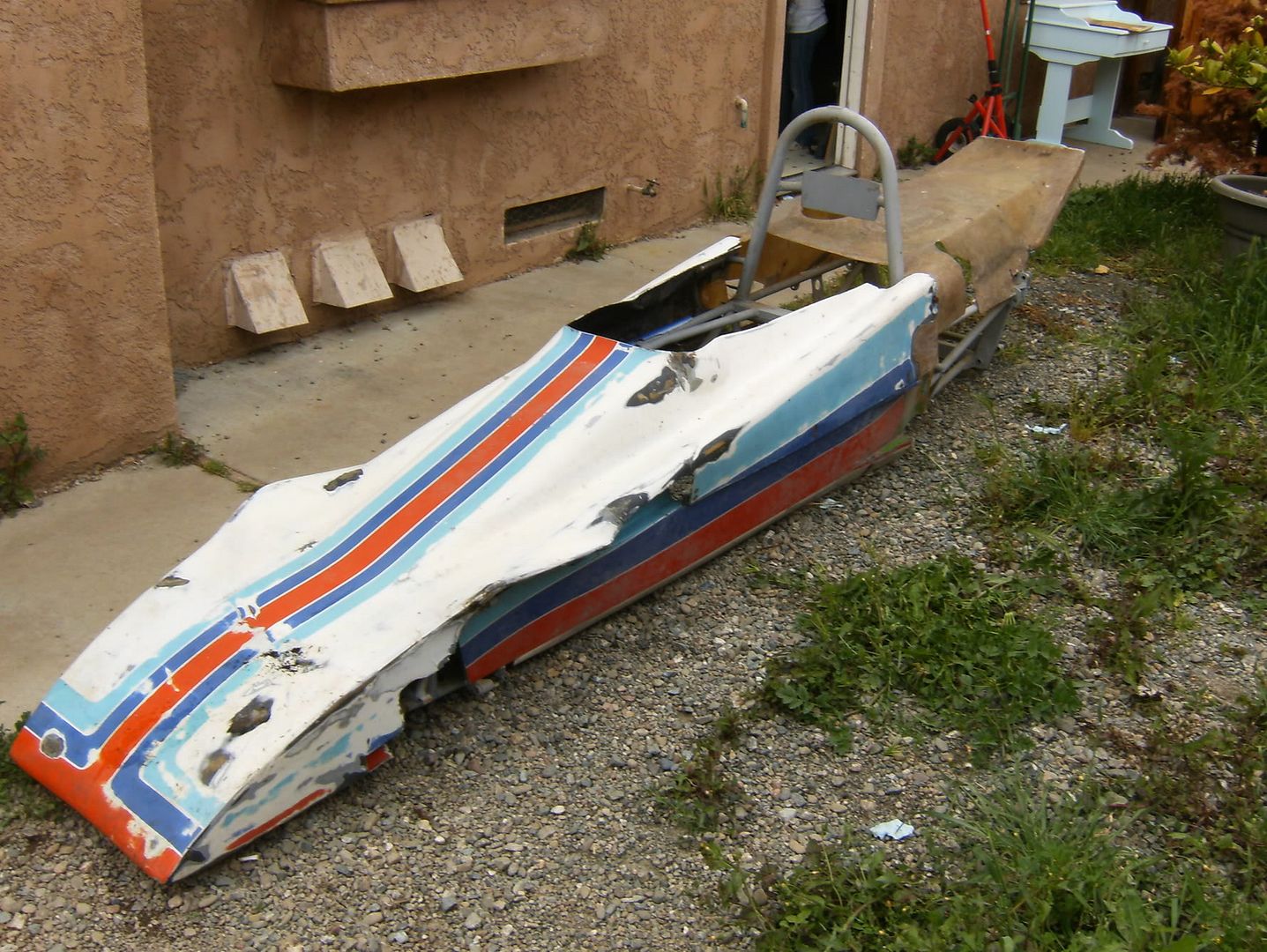

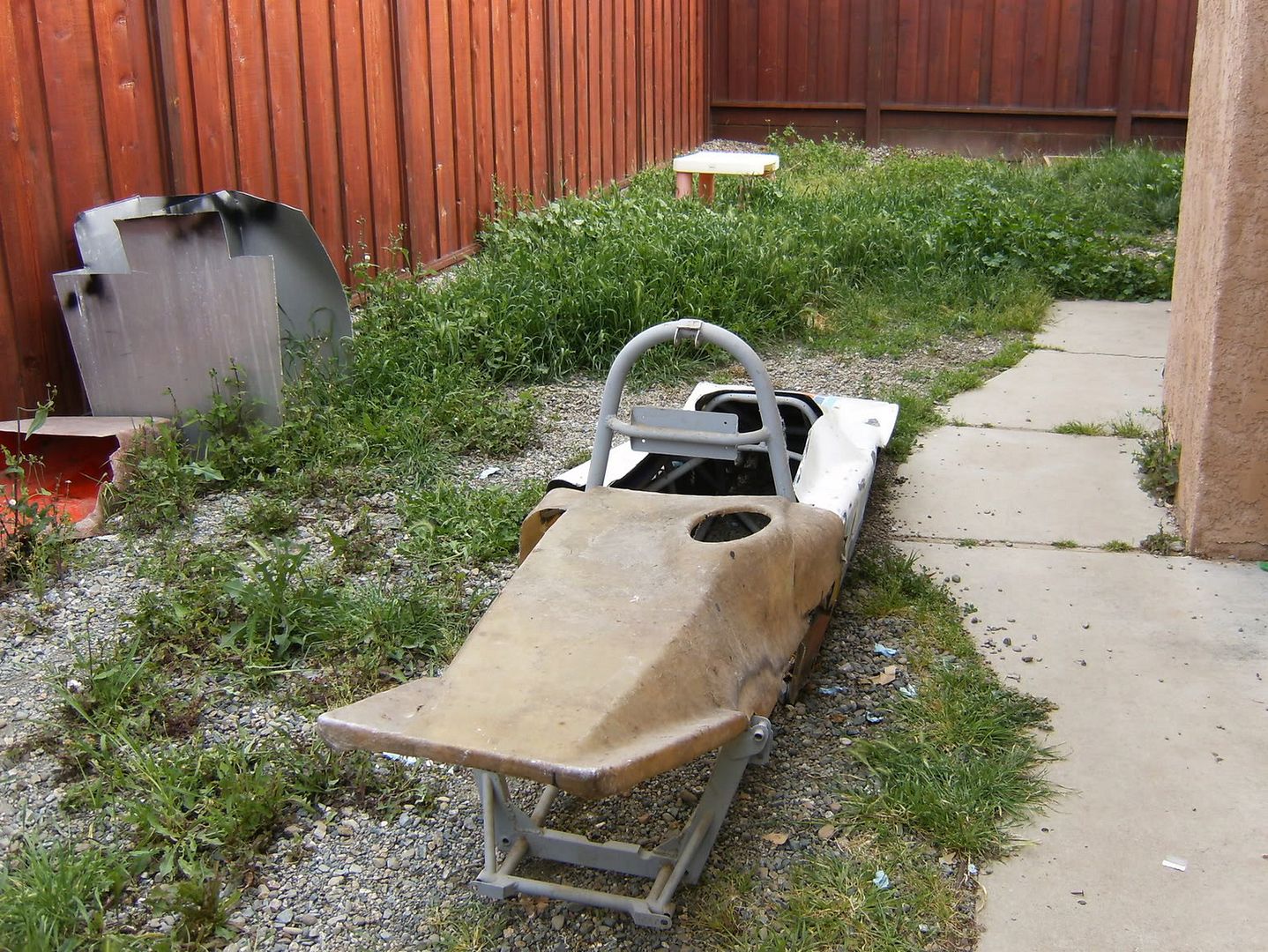

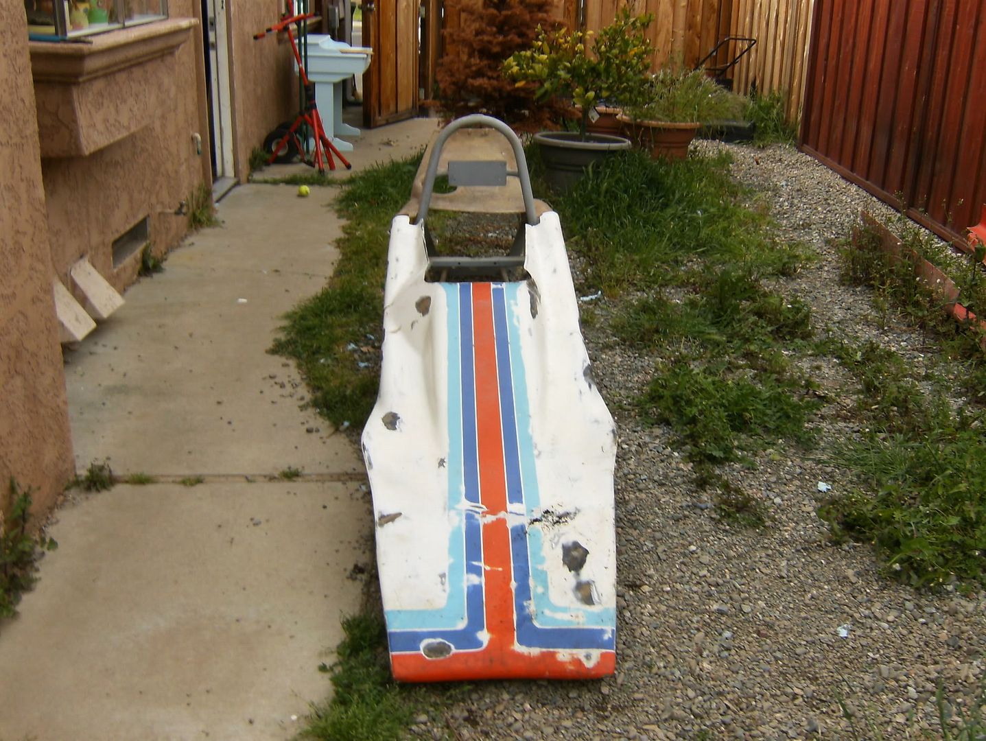

And some with the old busted body (and a tail cowl mold) on it.
I got it set up on jack stands in the garage and I took a good look around it. It doesn't appear to have ever had coolant or any fluid running through the frame. That's a plus.
So, please tell me more about what I have. Somebody might even recognize the body work and be able to tell me about the history of its owner/driver or the car itself. That would be pretty amazing.

The gas tank on these is a wedge shape that goes under your back. They wrap around the driver a bit and hold about 5 gallons. A fuel cell would be smaller and also expensive, though if you don't have a tank already that may not matter much.
I don't recognize the frame, it may be a lotus I just don't know. Especially if it's a Lotus, you should be able to find pics. The little extension to the frame at the bottom rear seems unusual, it may have been added on, though I don't know why. Perhaps this car doesn't use a long radius arm on the bottom?
Do you have the suspension also? Would be nice to see the front and rear uprights and brakes. You can see from the body work that this car wasn't using a front radiator, the pics above show how those work. If it was set up for that the upper frames tubes usually extend forward a couple of inches from the front bulkhead and the radiator hoses connect to that.
Perhaps you can get a pointer to your local SCCA region and their newsletter. A picture posted there would likely get you results.
Another unusual feature of this frame is the way the upper frame rails are tucked inwards in front of the dash. Perhaps the radiators fit in there somewhere? Do you have any radiators?

All the parts I have are pictured. :)
I planned on fabbing pretty much everything. The suspension is one of those areas that I planned on having to sorta develop/reverse engineer. Knowing what was there to begin with of course makes things a heck of a lot easier.

Just a suggestion, I'd redo the lower gussets on the rear bulkhead (bottom of 2nd pic) using a taco-style gusset in order spread the loads on face of the rectangular tubes and not the middle of the tube. However, if it's tied in to the tube running through the box section, then I take it back (looks like some work has been done to it... accident damage, maybe?)
