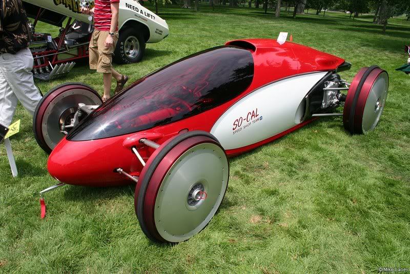

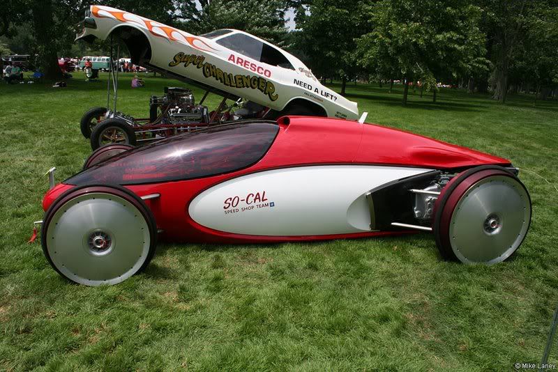

The front end has elements of the glider but the back end isn’t even close. Here is the rest of the story:

The lean machine appears to taper (from the top view) quite nicely at the rear...The bugev has an ok front for what it is. But rear aero is where the biggest gains are made, and the bugev has none to speak of.
I would guess the glider tail length is probably dictated significantly by the need to have adequate control of the aircraft with reasonably sized surfaces. The further back you put the tail, the smaller the protruding sections need to be to stabilize and control the plane. I bet from a strictly aerodynamic sense for a land vehicle, you would lose little to nothing while making it significantly shorter. The Aptera falls pretty well within that realm of shape, although it's for a side-by-side seating configuration rather than single or tandem so it loses out a bit due to its width.

If you take the degree of taper that exists to the right of the guy in the photo, extend it to the left until it comes to a point, then that should be as good or better than the full length fuse which is what I was trying to show. The Lean Machine tapers nicely but steeply, with a inverted T tail and strip lights. It would be more accurate to call it a trike than a middy, maybe a middy trike?

Yeah, that's what I was thinking too. So maybe half-ish the length of the glider for a more 'ideal' shape. I couldn't find a really good view of how steeply, or not, the lean machine tapers so it's kind of hard to say one way or the other.
