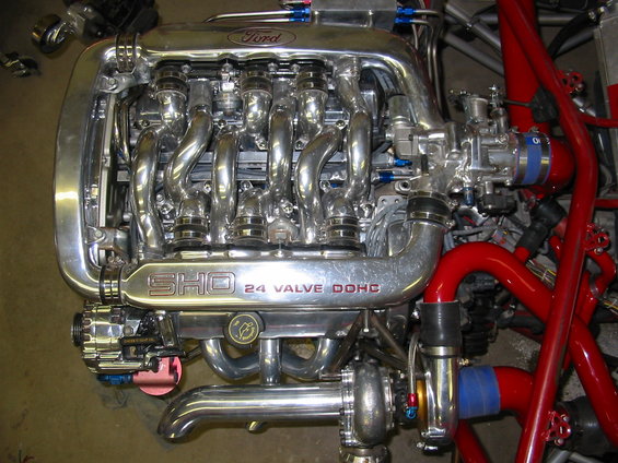

It's the same block as the 3.0 Duratec. The 3.4 SHO V-8 would sound bada$$ with headers. Pretty rare to find one in a junkyard that doesn't have piston and valve damage from their dreaded cam sprocket walk problem.
I want to use the 3.0 or 3.2 V-6 SHO motor in a Brunton Stalker sized car. I used one in my Off road car and put a blower on it for a couple of years and just changed it to a turbo. It screams at 6 psi.
