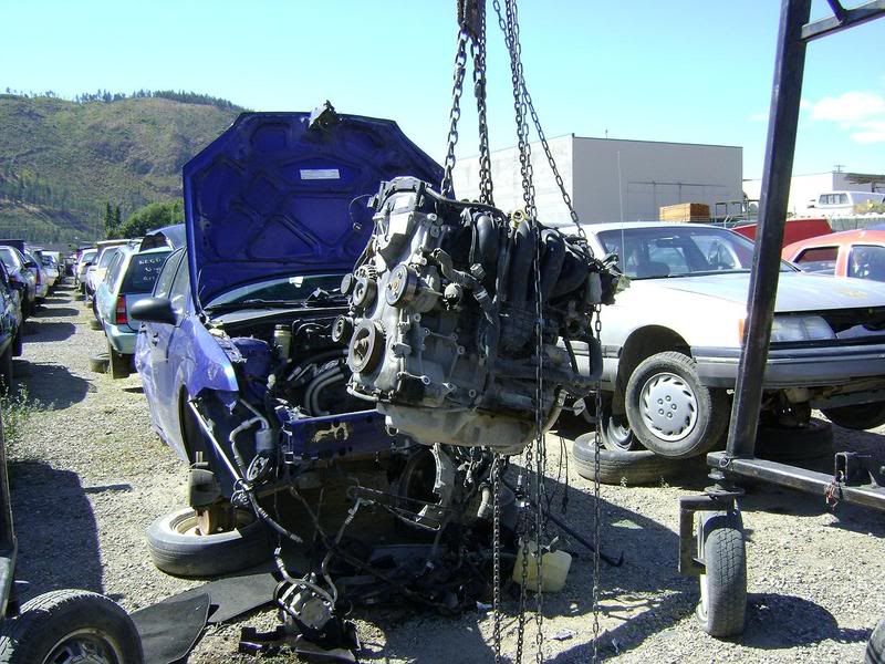

- SkinnyG
- Posts: 1340
- Joined: September 30, 2005, 1:28 am
- Building: Lethal Locost
- Location: Sunny-Okanagan, Canada, eh?!
- Contact:
- horizenjob
- The voice of reason
- Posts: 7652
- Joined: January 10, 2008, 4:47 pm
- Location: Massachusetts
SkinnyG, were you able to bring that home the way you lug your race tires around on the seven or do you stoop to driving some kind of practical vehicle to the yard?
Did you go for the 2.0 or 2.3?
Marcus Barrow - Car9 an open design community supported sports car for home builders!
- SkinnyG
- Posts: 1340
- Contact:
Sadly, the hardest part was lifting the engine out of the wheel barrow and into the back of my Nissan Hardbody myself - I foolishly left the canopy on when I went to the yard. So yeah, I sold the Sinister Sentra for the Hideous Hardbody. Sometimes practicality wins out.
But then, by removing the passenger-side arm rest I can fit both my kids' baby seats in the (standard size) cab.
I got the 2.0 to stay D/Mod legal.
G
